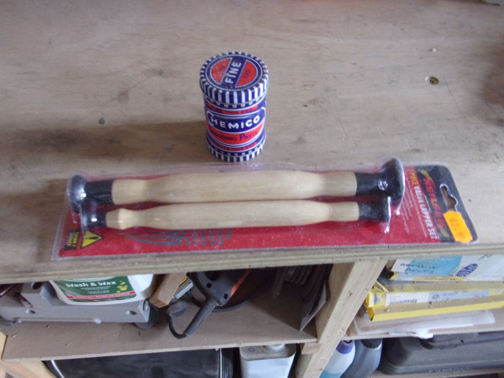

Anyone interested in engines will recognize these.
Valve seats nicely reground; one of the valves was tight to remove and this proved to be a rather nasty burr around the end of the valve stem; I've reground the profile and once the valves were reground I ensured valve clearances were perfect. These are wonderful jobs for anyone who likes to get their hands dirty but the skills are rapidly dying out in this throw away society we now live in.
Oh yes.
