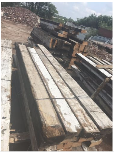

This is pitch pine available through eBay at £15 per cubic foot; a single beam will cost at least £60.

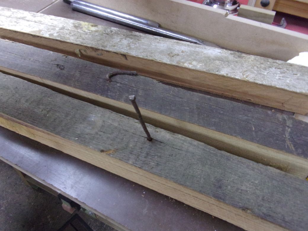

Here is what to expect; embedded nails are extremely dangerous and can ruin saw blades.

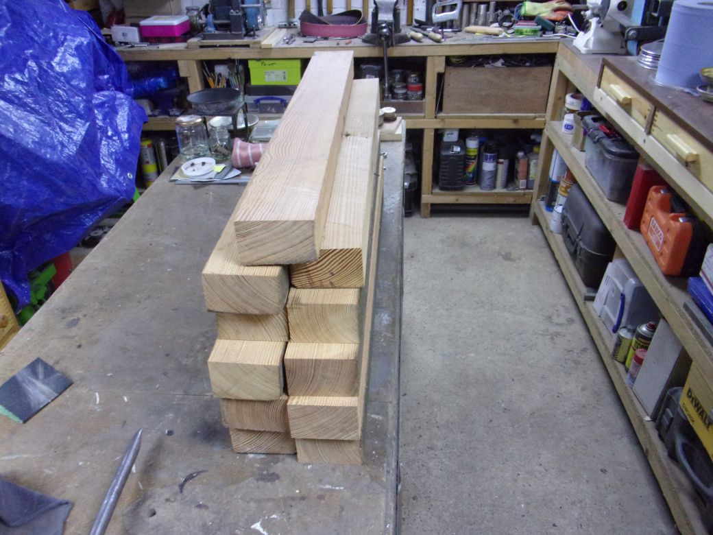

De-nailed and put through thicknesser. These cost £70 and all are not useable.

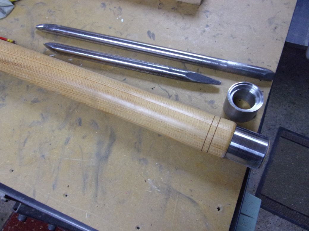

One of the metal spinning tool handles in pitch pine with a very strong steel ferrule; these tools are subjected to high leverage forces.
